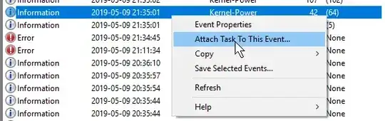

This is just a addition to Anders J's answer...
On Windows 10 in System log I right clicked on Event Id 42 and added task (bat script basically) with taskkill command from my comment...
