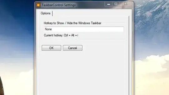

I found a program called "Taskbar Control" thats lets you set a Taskbar Autohide toggle key.
Taskbar Control
http://www.thefreewindows.com/3252/hide-completely-the-windows-taskbar-using-a-hotkey-and-unhide-it-with-taskbar-control/
Note: Make sure you download "Taskbar AutoHide Control" version if you want your current window to auto-fill the space.

  • there's no download link on the page. I guess it's removed? – Shayan Jan 12 '19 at 16:26
  • I downloaded from https://www.softpedia.com/get/Desktop-Enhancements/Other-Desktop-Enhancements/TheFreeWindows-Taskbar-Control.shtml – Shayan Jan 12 '19 at 16:27
