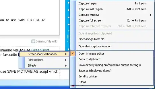

This is screenshot has been taken, when my video card was working properly
And this screenshot has been taken today (having problem with my video card)
So, anyone let me know, if you could figure it out, what could happened with my video card. In first screenshot you can see GPU temperature showing whereas in second screenshot it is not listed.
And, I took this screenshot from Device Manager, to let you know about my Video Card and its status.
And, sometimes my system shows 6 screens or even it looks like 8-bit system, where I get very worst graphics. And, suddenly, it works fine (when I restart my system). I went to nearest service center and they are charging for more than $160 to replace my 256 MB graphics card. So, anyone help me, what should I do ?

  • About the pictures, I can say that the temperature sensor in the graphics board is damaged or SpeedFan is not working properly or reading the correct info. A 256MB graphics board seems dated so I would recommend replacing it. Unless you state what kind of graphical problems you have other than this, we can't debug your problem. – Doktoro Reichard Oct 05 '13 at 18:35
  • What graphics card do you have? – David Schwartz Oct 05 '13 at 21:19
  • I have updated my screenshot by including video card status into it. Please see and let me know what do you think now ? – Ravi Oct 06 '13 at 11:17
