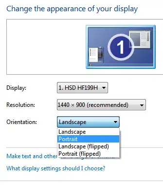

If "Extend.." is selected for Multiple Monitors (which Win7 will autorecognize) you should be able to select the "Orientation" drop down in the "Display" control panel (WinKey+R, desk.cpl) to change the orientation for each monitor. If your video card does not support this option, it may be grayed out, but I know the Intel HD Graphics series usually does.

Alternatively, you can go through the graphics settings as shown in Mitch's reply, but with both monitors connected. Click on the 2nd monitor (not shown above because only one is connected) and set the resolution to one designed for portrait, i.e. perhaps 1200x1600 or 900x1440, whatever the monitor supports. In this situation, the choices show resolutions for both portrait & landscape; you just have to pick the right one.
Most often in a dual-monitor situation that you describe, you may have to do both steps. However, you should be able to also do it through the display resolution dialog, as shown in the image:
display resolution dual mon
