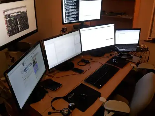

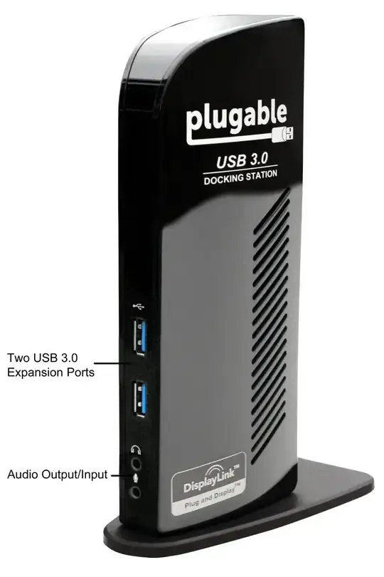

DisplayLink produces some chipsets that allow to convert HDMI / DVI video stream to USB. Plugable and Anker sell them (around 50-60 USD for one converter). It works for Windows and sometime on Mac (check the product's description). There is some experimental support for Linux.
I have 5 of them with my laptop and it works good for me:
I have recently switched to the Plugable UD-3900 USB 3.0 Universal Docking Station, as it can connect two monitors. Regarding the graphics:
  • HDMI port supports resolutions up to 2560x1440* and DVI/VGA port supports display resolutions up to 2048x1152 / 1920x1200; wired Ethernet port supports 10/100/1000Mbps speeds
  • Full support for Windows 10, 8.1, 8, 7, & legacy XP systems. Surface RT, Mac OS X, and Linux/Unix are not supported. Docking station suggested for use with web and productivity software; not recommended for gaming
  • *2560x1440 output only available when using a single HDMI display. If dual displays are connected, each will be limited to a maximum resolution of 1920x1200. 2560x1440 output requires a "High Speed" HDMI cable. 2560x1440 mode operates at a 50Hz refresh rate; all lower modes support 60Hz refresh. 2560x1440 output requires current DisplayLink drivers and attached monitor must natively support 2560x1440 via HDMI input
Plugable UD-3900 USB 3.0 Universal Docking Station rear Plugable UD-3900 USB 3.0 Universal Docking Station front
