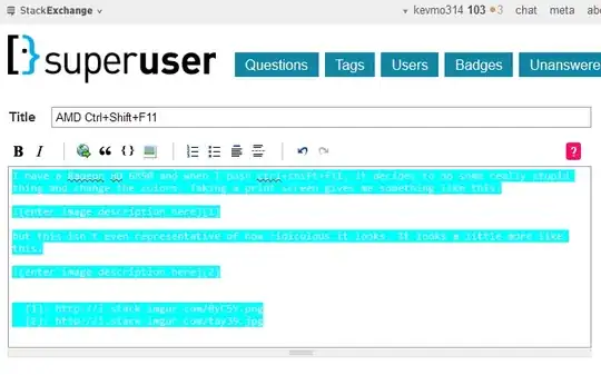

Now, I can fix the resolution and the colors by just changing the colors back, but now my text highlighting appears in cyan:
and even after trying to reset my display settings again, it's still cyan. Rebooting did nothing, reinstalling my graphics drivers did nothing. Does anyone know what this rather useless "feature" is and how I can fix my text highlighting? Also, how can I disable this functionality?

  • You might be able to fix your selection color by switching Windows themes and then switching back. – Oliver Salzburg Oct 10 '13 at 17:16
  • @OliverSalzburg: Just tried switching themes, text highlighting is still cyan. :s – kevmo314 Oct 10 '13 at 17:17
  • @OliverSalzburg: Aaand after switching a second time it fixed itself. Who comes up with this stuff?! – kevmo314 Oct 10 '13 at 17:18
  • My best guess is, the hotkey switches the card into a given profile (maybe it's a "hidden" one that's always available). When switched into this 16 color mode, Windows will change the selection color on it's own (due to the lack of colors it will try to find the closest match to the existing one or something like that). Really weird. Only found a few other similar reports online with no explanation. – Oliver Salzburg Oct 10 '13 at 17:23
