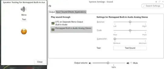

You can use the module to remap pulseaudio:
In a terminal:
pacmd list-sinks | grep name:
It will send you the name of the stereo output used. Then you type (replacing with the name you have found):
pacmd load-module module-remap-sink sink_name=mono master=THE_NAME_FROM_THE_PREVIOUS_COMMAND channels=2 channel_map=mono,mono
(In my case that was:
pacmd load-module module-remap-sink sink_name=mono master=alsa_output.pci-0000_00_1e.2.analog-stereo channels=2 channel_map=mono,mono
If you open the Sound Preferences you should now have a mono output available. To have that permanently:
gksudo gedit /etc/pulse/default.pa
then you add in the file:
#Remapping output stereo to mono
(The image is from the sound settings of Elementary OS Luna).
  • Very Useful... ;-) – Wilf Jan 26 '14 at 18:10
    How do you change the name of the new sink, to change the default name 'Remapped Built-in Audio Analog Stereo' in the System Settings - Sound GUI? – jII Jun 27 '15 at 20:47
  • Warning to people using PulseAudio Multiband Equalizer: this fix successfully put my sound output to mono but the equalizer stopped working. – Jam May 13 '17 at 18:52
  • This was extremely helpful. I'd suggest getting rid of gksudo since it's been removed from Ubuntu though. – Deoxal Nov 29 '20 at 08:12
  • @jII Use `sink_properties="device.description='your preferred description'"` in the command line. – jarno Nov 30 '22 at 18:20

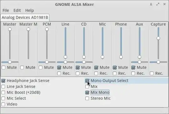

Installing Gnome Alsa Mixer by executing
$sudo apt-get install gnome-alsamixer
there are some options:
"Mono Output Select" and "Mix Mono"
    These options do not appear on every soundcard; when I installed it the only options there were "auto-mute", "IEC958" and "Loopback mixing", nothing to do with mono outputs. – Jez W Aug 02 '17 at 08:52
