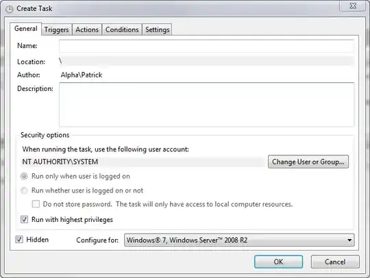

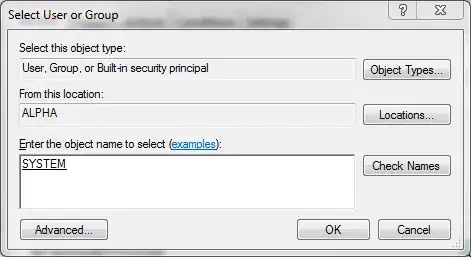

You can type in SYSTEM as a user in the Task Scheduler:
task scheduler 1
Click "Change User or Group..." and type SYSTEM into the box.
system object
Make sure you set the task to trigger if any user logs in:
triggers
