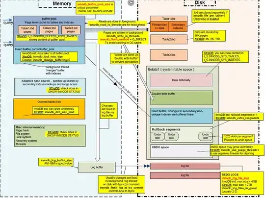

InnoDB has a very elaborate architecture in the background
InnoDB Architecture
InnoDB Architecture
In the event of a crash, InnoDB has the double write buffer and the log files to support mechanisms for crash recovery.MyISAM has no such protection. I have written posts in the DBA StackExchange about this:
MyISAM can crash too easily since data are never cached in memory. All read and writes require brute force I/O from the MyISAM tables .MYD file. This means open files handles that are at the mercy of OS.
If you want InnoDB to be repairable, you need to configure my.cnf to make InnoDB less reliant on the OS and more reliant on the Internal Architecture. See my recent post High average load due to the High mysql cpu usage. That way, InnoDB Crash Recovery can be more self-healing.
