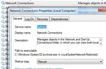

I experienced the same problem without any VPN set up. What solved it was to make sure the Network Connections service was running.
To enable the service, press the Win key, they start typing "Service". Go to Services, find Network Connections (click on the Name column to sort), right click, Properties, and choose Startup Type to Manual. Start the service, and the icon should change to the Wireless settings one.
I had disabled the service in an attempt to reduce the number of processes running on the system, and it didn't seem to cause any problem other than the icon looking like a network cable, instead of the wireless signal bars.
