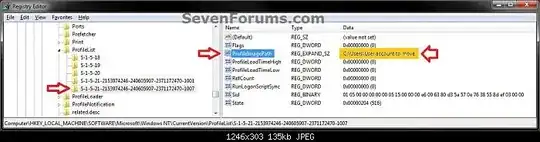

Here is a summary of the directions on changing the registry files linked to in the quote above.
Using Regedit navigate to the following location
HKEY_LOCAL_MACHINE\SOFTWARE\Microsoft\Windows NT\CurrentVersion\ProfileList
In the left pane under the Profilelist key, select and look at each S-1-5 key with the long number until you see the user account name and path (step 3) that you want to move in the value Data column of ProfileImagePath in the right pane. When the correct user name is found, right click on ProfileImagePath, and click on Modify. (see screenshot above)
Type in the full path of the location (ex: E:\User account to move) that you copied the user profile folder to in step 7, and click on OK.

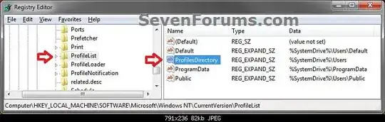

Also change the default location back to the default using Regedit to navigate to the following
In the right pane of ProfileList, right click on ProfilesDirectory and click on Modify. (see screenshot above)
type %SystemDrive%\Users
