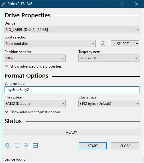

I did "DD" writing of linux ISO image in Rufus. It went well, linux boots from that USB stick. But windows does not show my usb disk anymore as drive.
But by Rufus it can be seen as "NO_LABEL (Disk 2) [16GB]". I just selected "boot section" dropdown menu to "not bootable", clicked "start" in Rufus. And voila my USB stick is now again recognized in windows :)
See screenshot.
