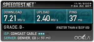

My brand new Dell XPS system has been running flawlessly except its abysmal download speeds. I have tried isolating every variable I could possibly think of but I can't figure out the problem. I've talked to Dell and Belkin without making progress (thought I'd try). Here are the speeds:
0.32Mb/s download 0.14Mb/s upload
Note that most of the time, upload speeds are actually much faster than download speeds (around 4.0 Mb/s which is better than most other devices on the network)
It's not the ISP. The slowdown happens even when transferring files inside the network. Plus every other wireless device gets approximately this:
7.21 Mb/s download 2.40 Mb/s upload
