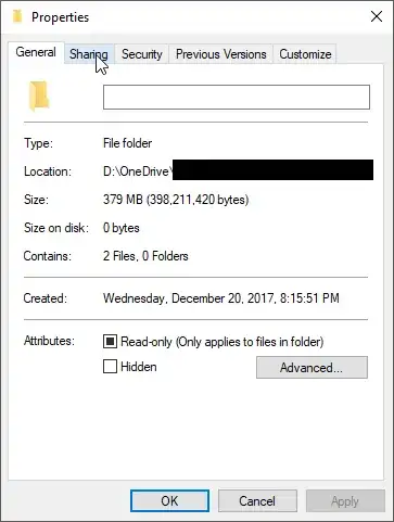

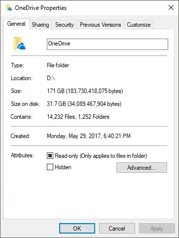

Another thing that may significantly reduce the Size on Disk value are situations where a file is not actually stored on disk but is still accessible through various means.
For example, the Offline Files feature of OneDrive enables a user to store a file in such a way that it is accessible via an internet connection. The file still exists on disk and has a certain size, but because it is not on disk until it is downloaded, it takes up no space.
Properties window of the OneDrive folder. The size of the folder is 171 GB, but the size on disk is 31.7 GB.
Example on a folder inside...
Properties window of a folder with a redacted name. The size of the folder is 379 MB, but the size on disk is 0 bytes.
