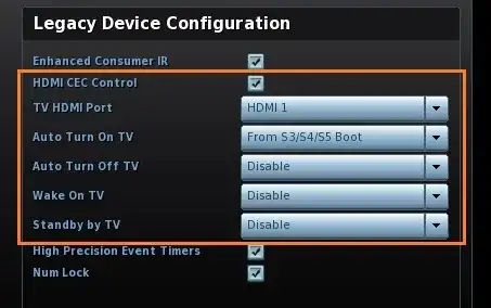

The latest Intel NUC's have HDMI CEC support:
  1. Onboard support (for power on/off only)
        Intel NUC HDMI CEC BIOS configuration

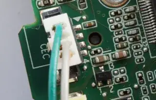

  1. And a header in case you want to do more via Kodi, for example with an adapter:
        Intel NUC CEC header
You can also back-port HDMI CEC to any PC (not only NUC) using this adapter.
