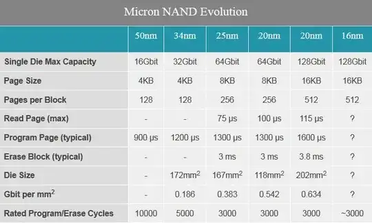

Fourth, block sizes are a function of the fabrication technology. The AnandTech article Micron Announces 16nm 128Gb MLC NAND, SSDs in 2014 has this interesting summary table, where block size goes from 512KB up to 8MB :
