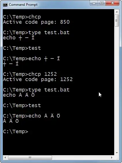

A batch file can not be of type UTF-8. It needs to be ASCII. Cmd.exe just doesn't accept another format. I did a small test and you can use your characters but it needs some work.
Make a file test.bat with echo Å Ä Ö. Save it with format ANSI/ASCII. Open a cmd.exe and make sure your cmd.exe uses Lucida Console (to display the Unicode characters).
When you type the file it will show characters as the old DOS-characters. You can see a translation chart here.
When you switch to a "Windows Ansi"-code page (i.e. West European Latin) with chcp 1252 the characters are displayed correctly. If they also get transferred to their respective utilities depends on that utility.

  • Well I have been looking for a way to do this in VB.net on Google for days, though I haven't found any way do do it. I already tried the example you linked and it didn't seem to work. How do I make sure that the .bat file doesn't use BOM? Also what is Lucida Console? The only info I could find about it is that it's a font. When I try the exact thing you did in the second example/image I get this http://i.imgur.com/6sh20j0.jpg – kagstrom2100 Nov 14 '13 at 09:36
  • I added to my answer to include `Lucida Console` and file-creation without `BOM` (Edit #2, at the bottom). But does creating this user via `net user` work on the command-prompt? And what does not work if you create it via VB.net? For this we would need some example-code (or a separate question) because this should work. (BTW you linked my image, not yours, i think, in your comment) – Rik Nov 14 '13 at 10:41
  • So I changed it to Lucia Console and not it seems to work. Though I need the script to run on other machines too and the Lucia console is only saved on the machine i changed it on right? I made a separate question for how to do this in VB.NET instead here http://stackoverflow.com/questions/19974473/making-a-windows-user-using-vb-net P.S Yes creating a user in command-prompt does work and yes I accidentally linked the wrong image :P – kagstrom2100 Nov 14 '13 at 11:11
