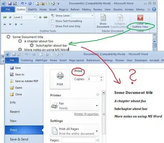

I'm currently typing up notes in Microsoft Word using the outline mode, but when I try to print this document it loses the outlining format and reverts to the original document:

The generel procedure to print the outline (with headers indented etc.) is to switch to outline view and then select the print function.
However, at least in Word 2010 this might be a bit confusing. When you access the print function you are switching away from outline view and you are also presented with a print preview on the right side of the window. This preview will display the document as if it was printed normally not using the outline. However, when actually printing you still get the outline.
If you want to only print the outline down to a level of your choice you simply have to customize the outline view by hiding lower level items before printing it.

    I just checked and Martin is right - this also works - and yes it IS confusing. – yosh m Jul 05 '11 at 20:19
    Thanks, Martin! How naive of me to assume that the print preview actually previewed what was going to be printed, so I gave up that path and kept looking until your answer here revealed I should close my eyes, tap my heels together and believe my outline will emerge, so +1 from me! See [my related question](http://superuser.com/questions/333577/copy-word-2010-outline-view-to-new-document) for another facet of outlining I am trying to figure out. – Michael Sorens Sep 09 '11 at 00:17
  • To clarify, while viewing your document in the Outline view **use the normal print function**; it _will_ print in Outline view, _despite_ what the Print Preview says. (Confirmed in Word 2016) – Nick May 10 '16 at 13:08
  • This is still a default behavior, 2019 – aaaaa says reinstate Monica May 13 '19 at 17:07
This was driving me crazy, too. Finally I found the way to do it. Instead of using the regular Print command (which switches to regular Print Layout view & shows you a print preview), you need to use the Quick Print command.
Here are a couple ways to access it:
  1. On the Quick Access Toolbar (usually it is above the Tabs in the window's title bar on the left side), press on the down-arrow to customize it. You'll see one of the commands you can choose is Quick Print. Select it to add it to the Quick Access Toolbar.
  2. Use the Search Commands tab (a tool available from the Office Labs site at http://www.officelabs.com/projects/searchcommands/ ) and search for Print or Quick Print - it'll show up in the results.
Now - how do you use it? First, set your Default Printer to the printer you want to use. Second, put your document in Outline view and arrange what you want to have shown (i.e., how many levels, etc.). Then press the Quick Print button and presto - it prints out what is on the screen, without switching to the Print Layout, i.e., in the Outline view.

    People who use Quick Print should know that it sends your document to the printer immediately without asking for any confirmation. If you want to choose the number of pages to print, etc., you're out of luck. – Alan Jun 29 '16 at 19:31

Outlining format by design will not print exactly what is shown in outline mode. If you want your document to look like what's on the screen when you print it, design it in print layout view (View tab -> Document Views -> Print Layout).

With the structure on "Navigation" right click on the top heading and then with the opened menu "Print heading and content" This top level should include all other levels. With the command "Heading and content you can see what is printed.

The solution posted by @Mokubai is the simplest in Word for Windows version 2106: With the document showing in Outline view, go to the View tab of the command bar and check the box next to "Navigation Pane" in the Show section. The navigation pane appears in the left side of the window. Click on Headings in that sidebar. Right-click on the first (topmost/level 1) heading and choose "Expand all" from the dropdown menu. Click on the triangles next to any sections you want to collapse, if any. Then right-click on the first heading again and select "Print Heading and Content." Voila! The print preview dialog appears and at last shows the outline with indenting, text, and images positioned just as they are on screen. Choose your printer and settings, then click "Print."

Microsoft XPS Writer is the only way I found to print the outline view exactly as it is. It looks like a PDF document but keeps all the formatting without defaulting to the main document. Microsoft XPS Writer is an optional printer.
