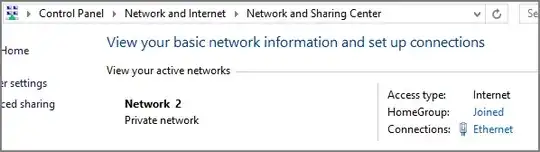

After looking through a bunch of drawn-out, technical answers here and elsewhere, I found and followed the directions here, which were extremely simple and worked perfectly, with one minor hiccup. Here's the steps:
  1. With the VMs powered down, in the main VB window go to File > Preferences > Network and click the + icon to add a network (NatNetwork, though I assume the name can be changed).
  2. In the network settings for each VM you want to connect, set adapter 1 to Nat Network.
  3. If it doesn't work, check the usual suspects, such as firewall, as well as the VM computer names. This is the part that had me for a while. After doing the above steps, the two VMs had different IPs and could ping each other, but their shared folders weren't showing up on the network on the other VM. Both had the same computer name, which I wouldn't expect to be a problem, especially since I couldn't even access the other via IP, but as soon as I changed them to be different things started working.
