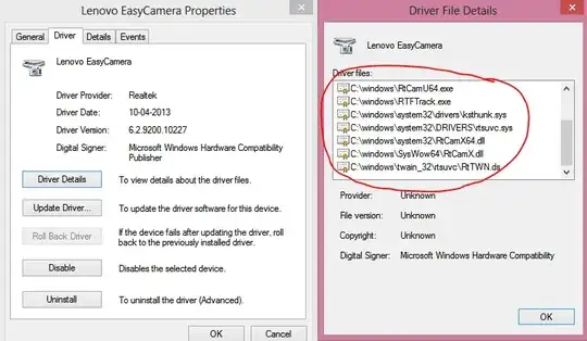

Make sure that before you uninstall the driver, you note down all the driver related files (DLLs, EXEs, etc.) that will be removed. You can do this by clicking on the "Driver Details" button in the driver properties window: Driver File Details
After driver uninstall is complete, verify that all the driver files were indeed deleted. If not, delete them individually. Now do a hardware scan in Device Manager (Action → Scan for hardware changes) and let Windows Update find the required drivers automatically. Windows might install a generic webcam driver and that might do the trick.
