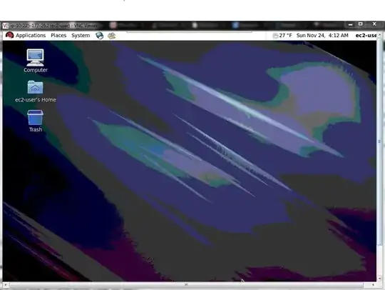

Now, when I connect using windows vnc client, I get the successfull connection but I get below window where nothing is clickable:

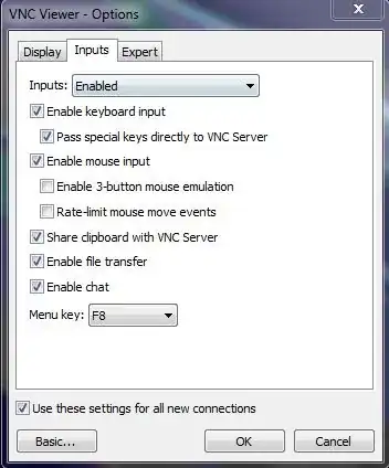

I have also checked below settings on my vnc client which will allow keyboard/mouse inputs:
QUESTION: I have never faced this issue before where the VNC console is "NOT CLICKABLE" And I am not able to figure what am I doing wrong. Could you help?
