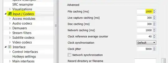

Go to the dropdown Tools -> Preferences, then on the preferences menu make sure you have All selected on the bottom left corner of the screen.
From there select Input / Codecs from the left hand side and scroll all the way down to the bottom on the right hand side to get to the section called Advanced.
In there the option for File Caching sets how many milliseconds of video to buffer in RAM when the video source is a file.

6Great! Thank you! This is right what I need. This has solved my problem with seeing squares when watching videos from a USB drive of mine. I have just put 10000 (10 seconds, as far as I understand) to all the fields and everything works perfect now. – Ivan Dec 04 '13 at 00:01
