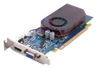

Low Profile cards are usually half the height of regular cards and come with a small bracket that doesn't fit into a standard slot, you need a specific slot.
alt text

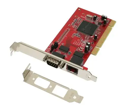

Low Profile ready cards come with a smaller bracket as well, so you can choose to install it on a regular or low-profile system.
alt text
The latter is best if you are unsure and want flexibility in the future.

Low profile ready are half-height cards that come like this:
alt text
