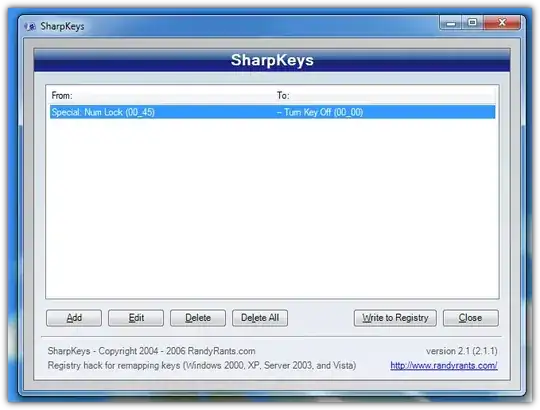

A good tool for such tasks is SharpKeys.
SharpKeys is a Registry hack that is used to make certain keys on a keyboard act like other keys. For example, if you accidentally hit Caps Lock often, you could use this utility to map Caps Lock to a Shift key or even turn it off completely.
It's small, portable and does the same as the accepted answer above, only via a GUI enter image description here

  • A definite +1, provides a nice basic GUI to modify the keyboard – topherg Feb 24 '14 at 15:10
  • It says there that its usable until Windows Vista, does it work for Win 7 and or 8? – Angelo Fuchs Oct 21 '15 at 09:45
  • I just used it on Windows 10 and it's working. Also it remembers the modifications you made allowing you to rollback easily. But you can't set the default state of NumLock with it, you'll have to modify the registry `HKEY_CURRENT_USER\Control Panel\Keyboard\InitialKeyboardIndicators` see VL-80 answer. – gwenzek Jun 23 '16 at 09:06
  • Perfect, I wanted Num Lock always on. Used https://superuser.com/questions/952669/how-to-automatically-enable-numlock-on-windows-10-logon to force it on on boots, and mapped Num Lock key to nil. Presto, Num Lock always on and can't put it off again. – TT. Jan 20 '18 at 11:09
  • This used to work but no longer does... – endolith Sep 14 '20 at 12:48

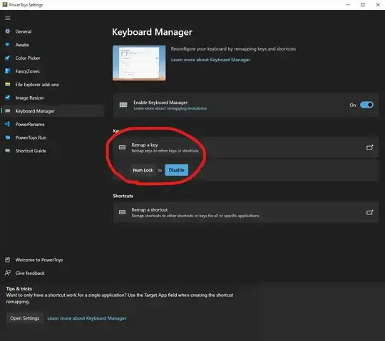

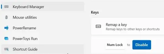

However, years after first posting this question, I discovered the Microsoft PowerToys utility, which runs in Windows 10 and 11 (that's what I'm using). You can download the installation file from GitHub. Here's the section which does what I want:

Power Toys
Please take a look at Power Toys in docs.microsoft.com
https://docs.microsoft.com/en-us/windows/powertoys/
Works on Windows 10
