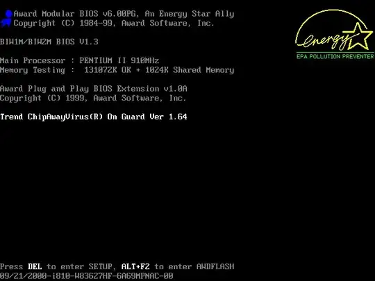

BIOS is stored in an EEPROM. When you turn on the computer, after the CPU gets ready for operation, it first goes to the EEPROM's address to find the BIOS program to execute. At the BIOS, the CPU checks for potential hardware malfunction, then starts the GPU. After that, peripheral devices are checked (USB, hard disk, keyboard, etc.). Finally, BIOS visualizes the startup screen. Below is an example of this screen.
Then, the BIOS reads system date and time and the connected hard drives from the CMOS to start the bootup sequence from the correct disk that stores the operating system files. Once the disk is determined, BIOS detaches itself. From that point on, operating system data are fetched from hard disk into DRAM. You know the rest :)
