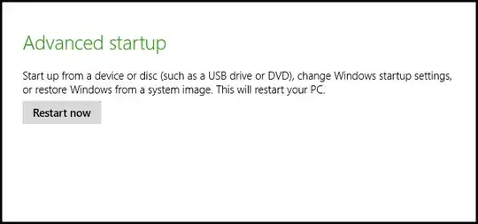

  5. You'll get the following display, where you'll need to restart your computer to continue, which will happen when you select "Restart now".
    Pressing "Restart now" before entering the startup repair menu

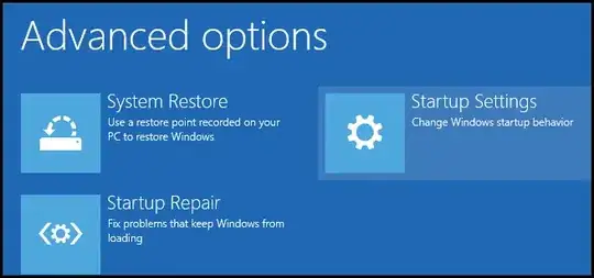

  7. Head into the "Advanced options".
    Select "Advanced options"
  8. Then to the core of what we're looking for: "Startup Settings"!
    Selecting "Startup Settings"
