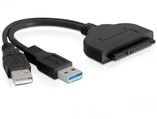

Among the other options of Linux boot, one could pull the drive and use a external enclosure, or hard drive to USB cable. USB
Or if you have an older drive (IDE):
ide usb
You can then hook it up to a different computer, scan for virus, check the SMART info, back up important files and so on.
