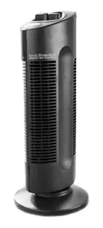

There are a number of types of electrostatic air cleaners that work in different ways. The worst for your purpose would be a simple ionizer.
enter image description here ionizer2
These just emit a spray of ions into the air that stick to dust particles. The dust particles are then attracted to surfaces where they stick. Most of these have a passive collection area, but that's a joke. All surfaces in the general vicinity will get covered and turn black.
