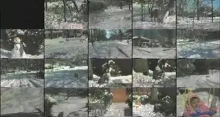

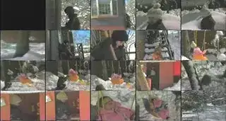

Here's the bonus: This 3rd PowerShell script generates a mosaic thumbnail image
You will receive one image per chapter video which all look like the example below.

The main idea is to get a continuous stream of images over the complete video. We do this with ffmpeg's select option.
First, we retrieve the total frame count with an ingenious method (e.g. 2000) and divide it through our default thumbnail count (e.g. 5 x 4 = 20). So we want to generate one image every 100 frames since 2000 / 20 = 100
The resulting ffmpeg command to generate the thumbnail could look like
ffmpeg -y -i input.mp4 -vf "mpdecimate,yadif,select=not(mod(n\,100)),scale=384:-1,tile=5x4" -frames:v 1 output.png

  • thumbnail which selects the most representative frames automatically
  • select='gt(scene\,XXX) + -vsync vfr where XXX is a threshold you have to play with
  • mpdecimate - Remove near-duplicate frames. Good against black scenes
  • yadif - Deinterlace the input image. Don't know why, but it works
Version 3 is the best choice in my opinion. All others are commented out, but you can still try them. I was able to remove most of the blurry thumbnails using mpdecimate, yadif and select=not(mod(n\,XXX)). Yeah!
For your sample video I get these previews
Click to enlarge
Click to enlarge
I uploaded all thumbnails created by those versions. Have a look at them for a full comparison.
nixda
