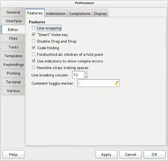

Geany's docs:
Line breaking column - The editor column number to insert a newline at when Line Breaking is enabled for the current document.
It doesn't look like there's a specific option to turn the indicator off, but perhaps setting it to column 0, or to something like 5000 might keep it out of sight at least. :)
