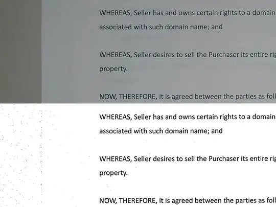

You can use Imagemagick's Mathematical Compose Methods to achieve such results. Divide_src [1] in particular as it would remove any gradients, vignettes, unwanted shadings.
Then a -normalize and a -threshold should do the rest.
convert $input -colorspace gray ( +clone -blur 15,15 ) -compose Divide_Src -composite -normalize -threshold 80% $output
Here's my result:
You may want to adujst the threshold to get the best results.
Depending ot the OS you are going to run this you might have to escape the brackets: "\(" and "\)".
As for the batch processing personally I would use a "for" loop either in bash or in Cygwin again depending on the OS:
for file in test/*; do convert $file -colorspace gray ( +clone -blur 15,15 ) -compose Divide_Src -composite -normalize -threshold 80% result/`basename $file`; done
