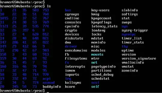

[EDIT] Here's a screenshot of what's inside the /proc folder: enter image description here

  • First you must understand the blockchain isn't 5Gb its actually nearly double that or at least its suppose to be. What are the user permissions on the proc folder, because the "no such file or directory" error likely explains some of the problem. Yes, I realize you used sudo. – Ramhound Jan 03 '14 at 12:17
  • @Ramhound - About the blockchain: it didn't finish downloading yet, so I didn't know how large it was in total. Regarding your question on the "No such file or directory" messages: the folder /proc/1094/ doesn't seem to exist at all. I added a screenshot of the contents of /proc/ folder. Does that tell you anything? (the contents of the /proc/ folder is a step outside of my knowledge..) – kramer65 Jan 03 '14 at 12:53
