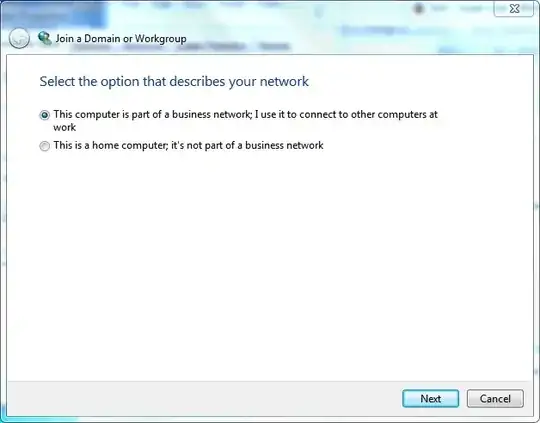

UPDATE: I just looked at My Computer > System Properties > Computer Name and found out that both laptops are members of WORKGROUP but not Domain. Is that okay? What if I change both to be members of domain?
Also only 2nd laptop has Network ID accessible where I can do the following:
