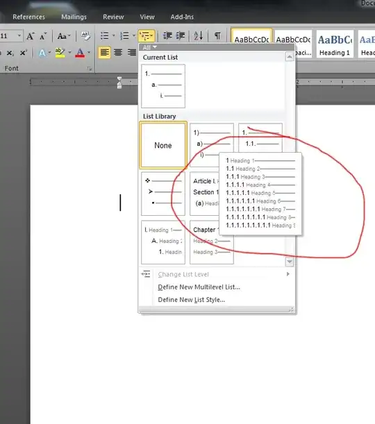

I have continued to get the error. Here is a picture from Win7 and Ms Word 2013. (I think this one I saved again as a new file and merged with the original where necessary).
I do have a network connection when I see this message.
I don't get this problem when the file is local.

  • @nhinkle did a further test, added pic. this with win7 word 2013. the problem happens when the document is opened over a network drive, windows file sharing, not when the file is local. It'd be interesting if you can confirm whether or not you get that problem when a file is open over a network drive and windows is put to sleep. – barlop Oct 16 '14 at 23:31
