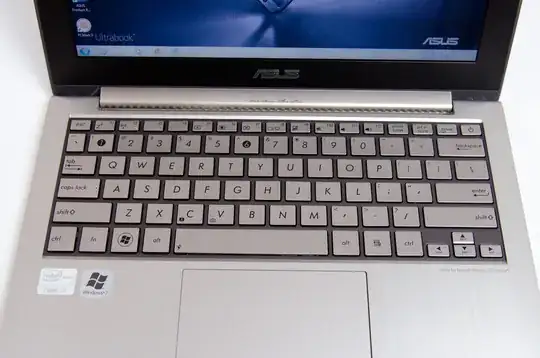

I'm trying to use a UK keymap on a physical US keyboard on my notebook (Asus Zenbook UX31E). My keyboard has vertical bar and backslash (| and \) above the Enter key, but I get hash and tilde instead. On UK keyboards, pipe and backslash seem to be just to the left of the Z key. Unfortunately, I don't have that physical key at all; instead, I just have a fat left Shift key. They needed an extra key to make room for £ and €, so things have moved around a bit, I guess.
I need vertical bar (for pipe) all the time in Linux, and, fortunately, found that with Right Alt+`.
Is there any similar trick for getting a backslash?  Unfortunately, I don't have a numeric keypad, so I couldn't get an escape sequence like Alt+92 working.
By the way, Shift+` gives me the "not" sign, ¬ (which I call "planking L").  I don't think I'll ever need that, so whilst an existing sequence to get a backslash is preferable, a solution that allows me to map backslash onto Shift+` is also acceptable to me.
By the way, I am using Gnome / Ubuntu 13.10.

  • please include a screenshot of the keyboard, that may help some people think of things. or others see the problem more clearly. And by the way, why not use a US layout for the US keyboard? – barlop Jan 21 '14 at 20:56
  • also, I found this comment on a forum, it may help. "I had the same problem, and it took me a long time to figure it out. In the top row of keys, right after the F* keys I finally found a small blue picture of a lock. This is the number lock key. Push the FN and the number lock key once to turn on the 10key function in the Qwerty keys and push them both again to turn it off." That said, I see no lock here though I can't zoom in much http://www.replacementlaptopkeys.com/images/asus_zenbook_ux31_laptop_key.jpg – barlop Jan 21 '14 at 20:57
  • http://images.anandtech.com/reviews/mobile/ASUS/UX21/img/DSC_4465.jpg – wim Jan 21 '14 at 21:01

    @DanielRHicks I've heard of numeric keypads being accessible with 7,8,9,U,I,O,J,K,L on notepads before, but I've never got it working because I don't seem to have a num lock key! Unless it is some obscure sequence. [There isn't anything obviously labelled NumLk on my keyboard](http://images.anandtech.com/reviews/mobile/ASUS/UX21/img/DSC_4465.jpg). – wim Jan 15 '14 at 12:55
  • On my keyboard (on a Sony Vaio) with identical layout the NumLk key is to the right of F12. But those 4 keys on the right are labeled differently from mine. – Daniel R Hicks Jan 16 '14 at 12:32
