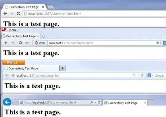

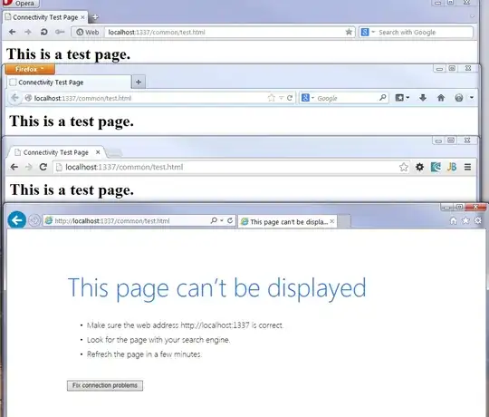

I have a NodeJS server running on my local machine for development purposes. By default, it uses port 1337. (I've tried a handful of other ports such as 8080, 1234, 9000, 9090, 65432 et al).
I can successfully connect to this NodeJS server from Chrome, Firefox, and Opera. But, when I try to connect with Internet Explorer 11, I see "This page can't be displayed" (see image).
I've tried a variety of "solutions" and viewed several questions/answers on this site. None of them have worked. Including:
  • I've tried 127.0.0.1
  • I've disabled "Protected Mode" and "Enhanced Protection Mode."
  • I've added "localhost" to the Intranet Zone and Trusted Zone.
  • I've disabled "Friendly HTTP messages" hoping to see more detail.
  • I've tried using my machine name and DNS name.
  • I've tried creating a manual entry in my hosts file for "localhost" and even "thisismyfrigginpc" using my IPv4 address.
The only success I've had is when the server runs at port 80 (http://localhost:80/ or http://localhost). However, I can't develop on port 80 for a variety of reasons. I need to test my code on localhost+port (some port, any port other than 80 and 443).

Fired up a XAMPP Apache server on port 1337. IE connects to it just fine. So, there is something about the NodeJS response that IE doesn't like and the other browsers seem to handle well. We will be investigating our NodeJS code to see what exactly it happening in the headers/content to see if anything is out of line.
Update 2014-01-27: Resolution
I just wanted to document the results. The original response included Content-Type: text/html;charset=utf-8 and based on the correct answer, it should be: Content-Type: text/html; charset=utf-8 with a space between the type and the charset.
