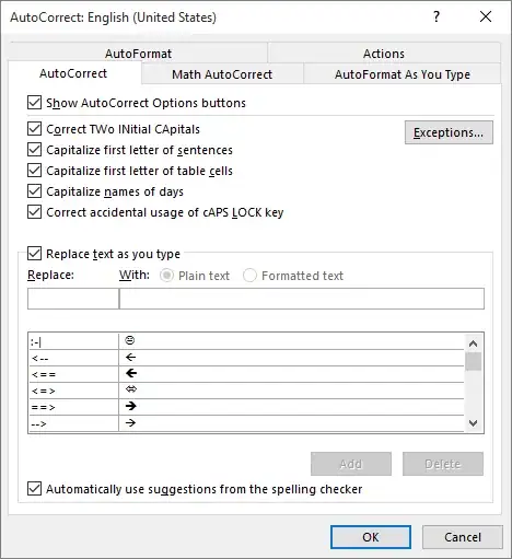

There are various ways to do that
1. AutoCorrect
By default --> will be changed to a light right-pointed arrow. Similarly ==> will be a heavy right-pointed arrow. There are also other types of arrows and you can also insert your own ones so you don't need any shortcuts
AutoCorrect arrows
Of course this needs AutoCorrect to be turned on. If it was turned off, you need to turn it on again by selecting File > Word Options > Proofing > AutoCorrect Options... > Replace text as you type
A downside of this is that many of the arrows are from the private use area like U+F0E0 U+F0E8, therefore you can't copy them around to other applications easily, but of course if you only use them in Word then it'll be fine

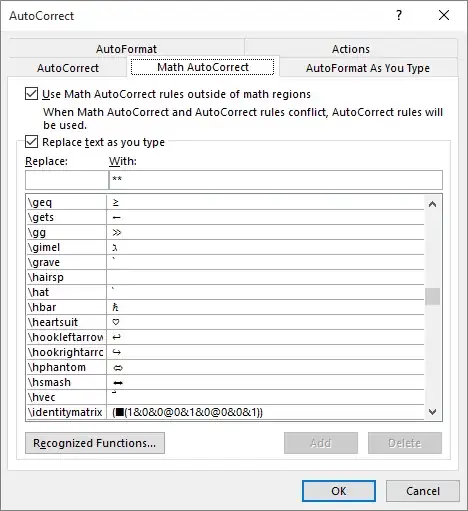

2. Math AutoCorrect
With this feature -> will be converted into → by default without doubling the hyphen.
There are even more types of arrows, including curved ones and diagonal ones like \asmash \hsmash \hsphantom \mapsto \lrhar \searrow \swarrow...
This needs Use Math AutoCorrect rules outside of math regions to be turned on beside the normal AutoCorrect.
