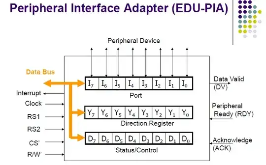

Below is an image of a simple, basic computer system. The case is much more complicated in contemporary systems.

You are writing to the registers of the I/O interface through the data bus, which later (when ready) sends the data to the actual I/O device. Below is an image of an example I/O device interface.

  • @barlop For your second question, you are right here, what I meant was "Below is an image of an example I/O device **interface**". I corrected this in the edit I just made. I hope that edit eliminated the confusion. If not, ask more. I'll try to answer as best as I can. – Varaquilex Jan 19 '14 at 02:26
