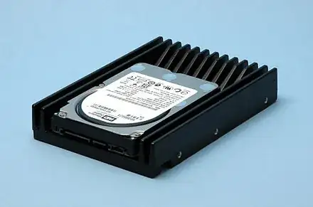

After clarifying exactly what you are referring to by bare drive, I should point out that cooling probably will not be an issue. For a long time I had a WD VelociRaptor 2.5" drive sitting outside the chassis of one of my computers connected via external SATA. This drive runs at a demanding 10K RPM but only requires passive cooling. The drive itself is 2.5", but it has a heatsink built-in that makes it occupy a 3.5" form factor:
Your drive should not require anywhere near the same level of sophistication in terms of cooling as the WD VelociRaptor. But it would be a good idea to put it somewhere with good ventilation since you are going to run the disk continuously to get the data off of it.
