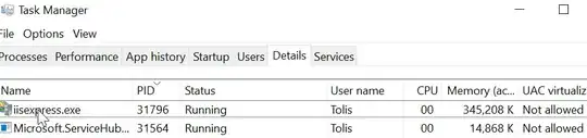

netstat -aon|sls 61456
TCP 127.0.0.1:61456 0.0.0.0:0 LISTENING 31796
finally I open Task manager and looked sort the PID column looking for 31796
