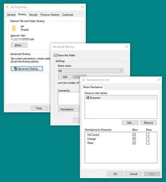

  9. Create a folder in the laptop and share it (try using very short names, there's a limit of 15 characters) enter image description here
