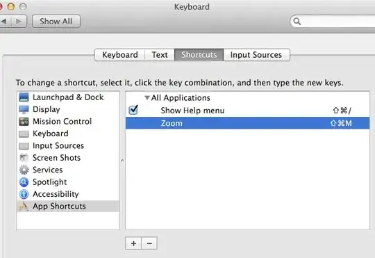

Assign a shortcut for the Zoom menu item (or whatever it's called in your locale) from System Preferences:

  • Was thrown off by the word 'zoom', but setting 'Zoom' to `cmd+m`, and setting minimize to `cmd+shft+m` as per [this answer](https://apple.stackexchange.com/a/125628/265900) allowed me to maximize with the former and minimize with the latter. – shoe Jul 06 '19 at 05:26

To maximize the active window(application), you must assign the operation to shortcut key as follows;
  1. Go to System Preferences>Keyboard>Shortcuts>App Shortcut, then click "+" to add shortcut key.
  2. Choose "All Application" which means this change will affect all application, put the text "Maximize" in "Menu Title" textbox and press "Command+Shift+M" in "Shortcut Key" textbox.
  3. Restart Window(Application) which you would like to affect by the shortcut key.(No reboot requred)
  4. You will find new menu item in the menu bar also.
