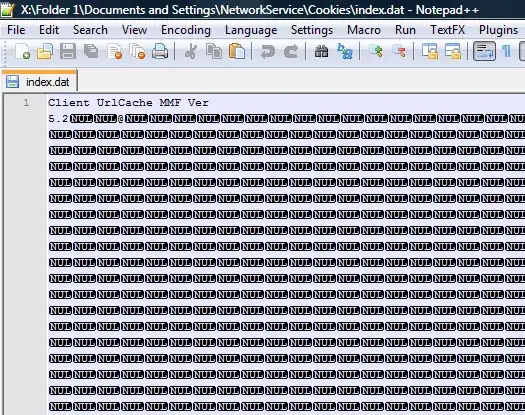

Whenever I open a file that contains NUL characters in Notepad++ my monitor starts to emit high pitched, squealing kind of noise. It doesn't always do that. There is certain criteria to be fulfilled. It largely depends on how many they are, and also if they take up a single line, or several lines.
Consequently it also depends on having word wrapping enabled or disabled.
  • If I have a long line with NUL characters but word wrapping is disabled then I won't hear anything.
  • If I enable word wrapping so that the entire program window is filled with them, and ultimately my entire monitor when the program window is maximized, then I will be able to hear it clearly.
If I restore the program window and make it smaller, then I will only hear it a little bit. So I can actually control the amplitude by clicking the lower right corner of the program window and dragging it in X or Y direction. It's kind of cool actually! LOL! :) It's a fun side effect, like playing with a synthesizer. But I don't really want it, it gets boring after a while.
So this would NOT produce the noise...
NO
And then this WOULD produce the noise...
YES
Both of these screenshots were taken with the program window maximized.
It's not only limited to NUL, I get the same result with other control characters like STX and EOT. It's only when I open the file inside Notepad++ that the problem is seen. Well your regular Notepad that comes with Windows cannot display control characters, so that's pointless to even try.
So the following conditions apply.
  • There are several control characters in the file (NUL, STX, EOT, etc).
  • There is more than one line (or one long line wrapped to fill the window).
  • Program window is maximized (ideally, in order to hear it better).
Any ideas? Why is this a problem? Anyone had the same or a similar experience, i.e. hearing high pitched noise from the monitor in one program but not in others?

  • if you take a screen shot of that Notepad++ window with all the NULLs, close NP++, then view the save screenshot, does the squeal still happen? – Ƭᴇcʜιᴇ007 Feb 24 '14 at 20:45
  • Yes it does. So it's my monitor then? – Samir Feb 24 '14 at 20:50
  • Most likely (inverter perhaps?). Try the same monitor on another computer, try another monitor on this computer, try a different video cable, try rerouting your existing video cable away from other cables. – Ƭᴇcʜιᴇ007 Feb 24 '14 at 20:52
  • I will try that. However, I have two of these monitors on the same computer and I have the same problem on both. So chances are that it's just a problem with this model. Displays are not exactly made to display control characters. I don't have any issue with displaying a full screen with regular text. – Samir Feb 24 '14 at 21:02
  • FWIW, I have posted some specs on the hardware. Is this something that would be covered by the warranty? – Samir Feb 24 '14 at 21:04
    Weird for sure, but keep in mind that the monitor doesn't know (or care) that it's displaying control characters, it's all just pixels as far as it's concerned. :) – Ƭᴇcʜιᴇ007 Feb 24 '14 at 21:04
  • Sammy - Check it out man: http://superuser.com/questions/1125281/why-does-my-computer-make-a-screeching-noise-when-notepad-is-open-with-nul-cha did you ever find a solution? If so, you should add an answer on this post. – Vomit IT - Chunky Mess Style Sep 17 '16 at 02:12
Try making a screenshot of Notepad++ screen with NUL's and post it to your monitor from another application (image viewer). If the noise is still present, it is not Notepad++.
It is possible that either horizontal or vertical pattern which utilizes maximum contrasts (back vs. white) creates this as an side effect. Try to reproduce similar pattern in Paint or other program and see how it affects your monitor.
