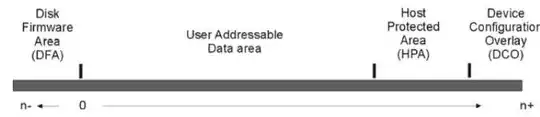

Here's an overview of the disk areas:
disk firmware area, user addressable data area, host protected area, and device configuration overlay

Disk Firmware Area (DFA)
In most cases this area is the one that is called service area.
The firmware is composed of a series of modules. Examples are: SECU (Security System Module), P-List, G-List, T-List, SMART Attributes, and U-List (Firmware Zone Translator). See also Bad sector remapping.
A portion of the disk firmware usually resides on the drive, loaded on power up by code located on the controller board of the hard-drive and managing the disk until the disk is shutdown, or sometimes residing in flash memory located on the disk controller chip.
Host Protected Area
The Host Protected Area (HPA) is used for holding diagnostics and other utilities required by the manufacturer such as the boot sector, the exact content depending upon the manufacturer. It may contain information about the user addressable sectors, start of the reserved area, and code for booting.
Device Configuration Overlay
A Device Configuration Overlay (DCO) is similar to the HPA, but is used by manufacturers to configure drive sizes and may exist in addition to the HPA.
Its purpose is to allow the PC manufacturers to purchase one disk and market it as different models of different sizes. It can also be used to enable and disable features on the disk.
