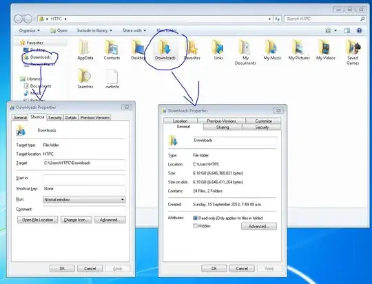

You'll need to point the Downloads library link back to D:\Test\Downloads.
You can do that through Right Click > Properties then selecting the Location tab.
  • Restore - This will set the path back to default, as you see in the screenshot.
  • Move... - This opens a window that will let you choose a new location for the downloads directory.
  • Find Target... - This will open the directory where the currently set Downloads folder resides. In the example below: C:\Users\Michael\
Download Properties
Note: You can only get to the "correct" Downloads properties by entering from the \Users\Username\ folder directly. See the screenshot below:
Download Properties 2
If the above method doesn't work or the Location tab is completely gone, and you're not just looking in the wrong place. You may need to reset the Download folders registry link.

  • I've expanded my answer to include a screenshot of which icon to enter properties from. I can't see if for some reason, hopefully you can. – Michael Frank Feb 28 '14 at 19:30
