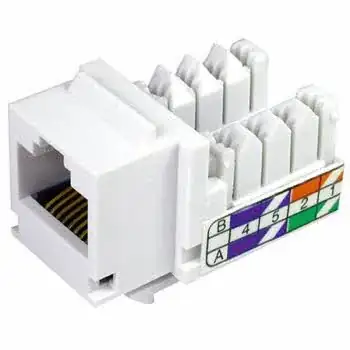

Somewhat unrelated, if we are able to route between these fiber strands successfully, what is the physical connector type used in a jack on the wall? Just like RJ45 has a wall outlet (depicted below):
RJ-45 jack
What is the fiber optic equivalent of this? In the interim could we "patch" a couple fiber strands together in the network closet? Would signal loss be of concern with a run length of 100-200 feet, a patch cable and two media converters? If that would work then it could be used until the funds are available for more.

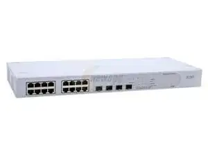

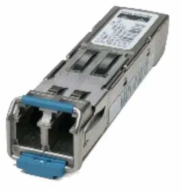

What you are looking for is NOT a fiber channel switch. You are looking for an ethernet switch with SFP slots, unless you want an antique (GPIB slot). While you can purchase SFP switches with no copper slots, it's often not the best or most affordable solution. Then you need SFPs (Small Form Pluggables) which are the devices that actually connect to LC fiber optic connectors and plug into the slots.
LC connector Bulkhead
On the low end you can get Gigabit 8 copper 2/SFP ethernet switches for $100 each, or less. Be careful not to buy 100Mbit when shopping used stuff. Much larger than life, an SFP:
SFP
An SFP switch (this exact one possibly no longer available new, but there are many, and used works fine in most cases anyway) with 16 copper and 4 SFP (fiber) slots
SFP Switch
