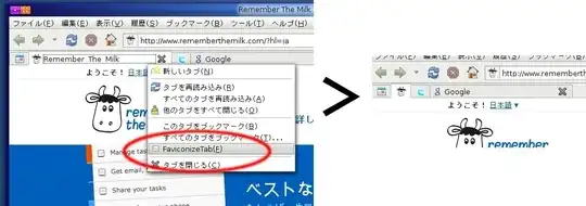

Also FaviconizeTab might make it more reasonable to have hundreds of tabs open
