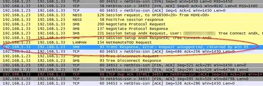

It's the same with two DOS-machine of mine. One gives error 50 (unsupported) and the other gives error 1 (like yours). It think the problem is with the protocol used by NET to request the time (and also the 'NET VIEW' command). If i take a quick look at WireShark on the Windows 7 machine i can see the following traffic (image below):
DOS-machine is 192.168.1.23 and Windows 7 machine is 192.168.1.33
Command used on DOS is NET TIME \\XPS8500
You can see that the DOS-machine (192.168.1.23) requests NetRemoteTOD via the LANMAN-protocol. Which isn't supported anymore by Windows 7 (as you can see by the answer back).

It's the same with the NET VIEW command. From DOS NET it uses the LANMAN-protocol to request a NetShareEnum while from Windows XP it uses SRVSVC to request a NetShareEnumAll.
