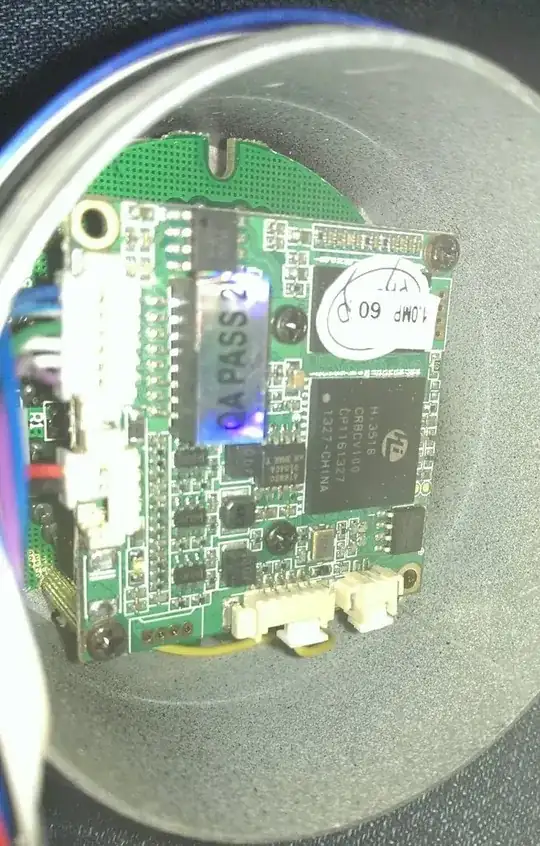

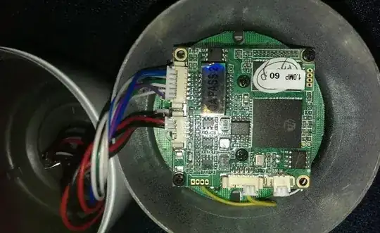

I tried a crossover cable; it did not work. Plugged it in, no response. Checked Wireshark and it was a ghosttown, except for me. Here are a couple images:
The area on the underside of the board is the CMOS sensor and lens apparatus. The second board underneath has no connection to the mainboard except for power. I wasn't expecting the CMOS sensor to be so exposed, so when I lifted the top board, I shivered in fear!
2 ideas for you: 1) Look for a "reset to factory defaults" switch or button or anything that can be shorted or pressed :) 2) Ask the seller the name and password of wifi network he used to connect it to, then duplicate it on your router. It's likely that you only killed wired, not wifi interface and old settings might still be there
Alec Istomin
  • 629
  • There doesn't seem to be anything that I can press or jump on the board. I asked the seller a few days ago for any information, but to no avail. There is no wireless on the device. :( – Kevin Evans Mar 19 '14 at 14:11
  • Disassemble (maybe there is something on the other side of the board) and then start shorting literally everything... :) – Alec Istomin Mar 19 '14 at 23:00
