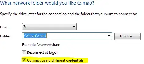

You can also specify different credentials using the Windows Explorer GUI. From the Tools menu select Map network drive.... On the Map Network Drive dialog window there is a checkbox for "Connect using different credentials".
Note: If you do not see the menu bar in Windows Explorer, press the ALT key to make it appear.

When you map the network share from Windows Explorer (right click on share name > Map network drive) you can use different user credentials:
Map network share
